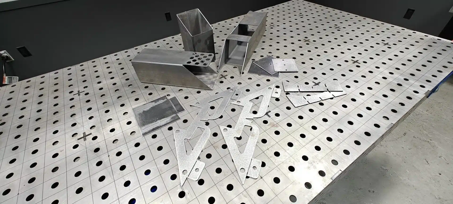

The PYRIKX Rocket Stove Parts
PYRIKX-Rocket-Stove-Parts
I feel like the number of parts in the kit in the kit is manageable. And I’ve tried to incorporate some design elements which minimize the necessity for additional fabrication.

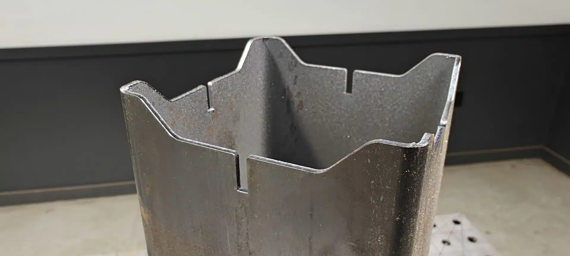

For example, with any rocket stove, if you want to place a pot or skillet on the top to capture the heat, there has to be an air gap for the hot gases to continue to flow. If the top is flat, and you place something over it you simply choke off the air flow and combustion stops.
Since we’re laser cutting the tubing, I incorporated raised corners directly into the design so something can be placed directly on top without impeding the flow of hot air.
Rocket-Stove-Raised-Supports

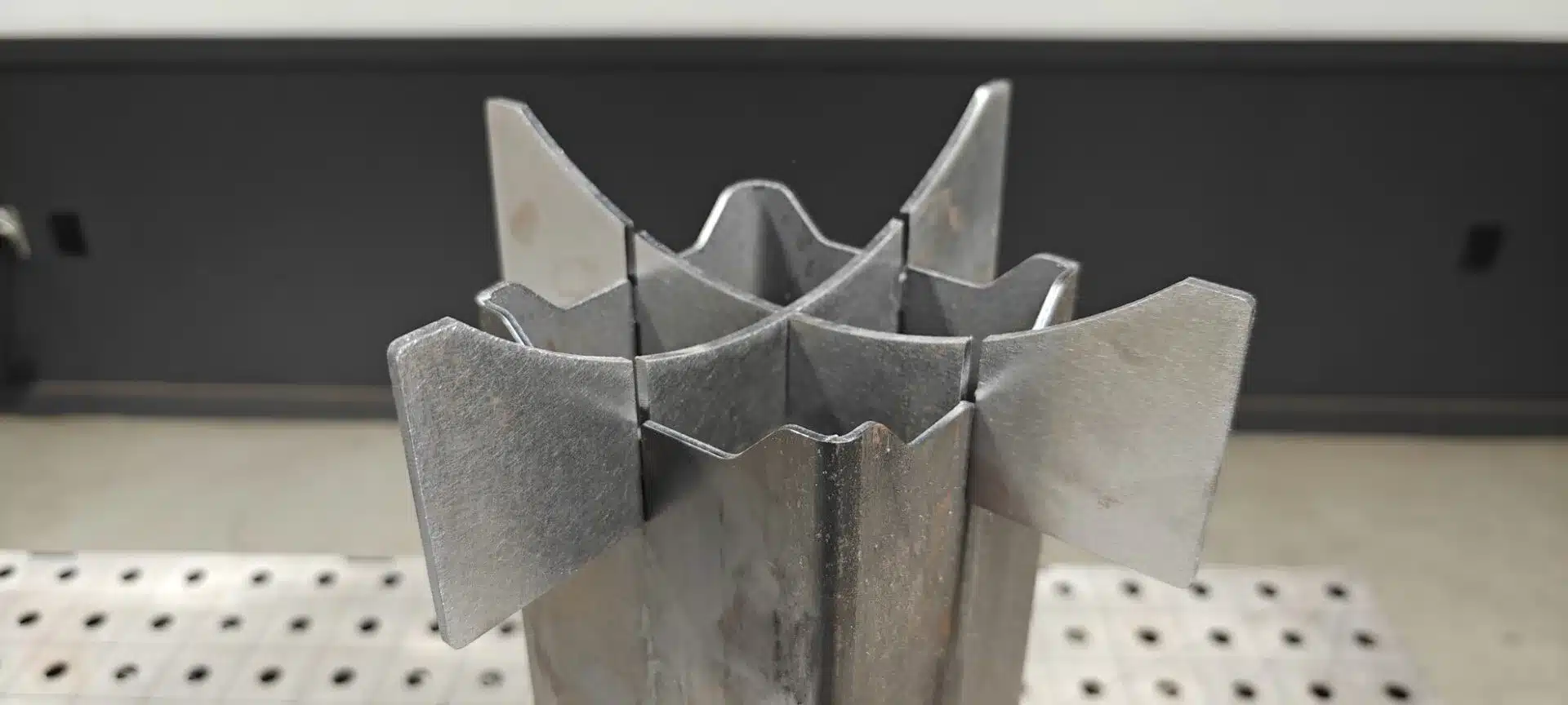

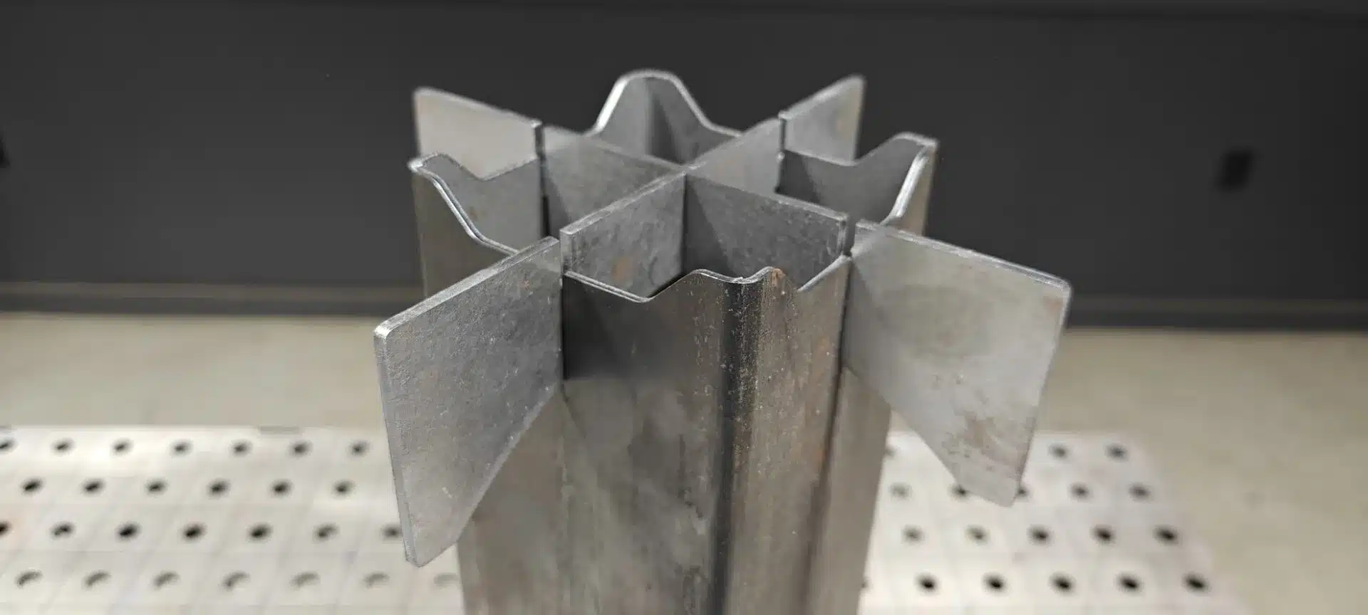

Additionally, there are small slots at the top of the stack to allow expansion grates to be inserted to provide a wider base for things to sit on.
Rocket-STove-Support-Slats
And while we’re at it, I made those slats reversible in case you want to use a wok instead of a flat pan.

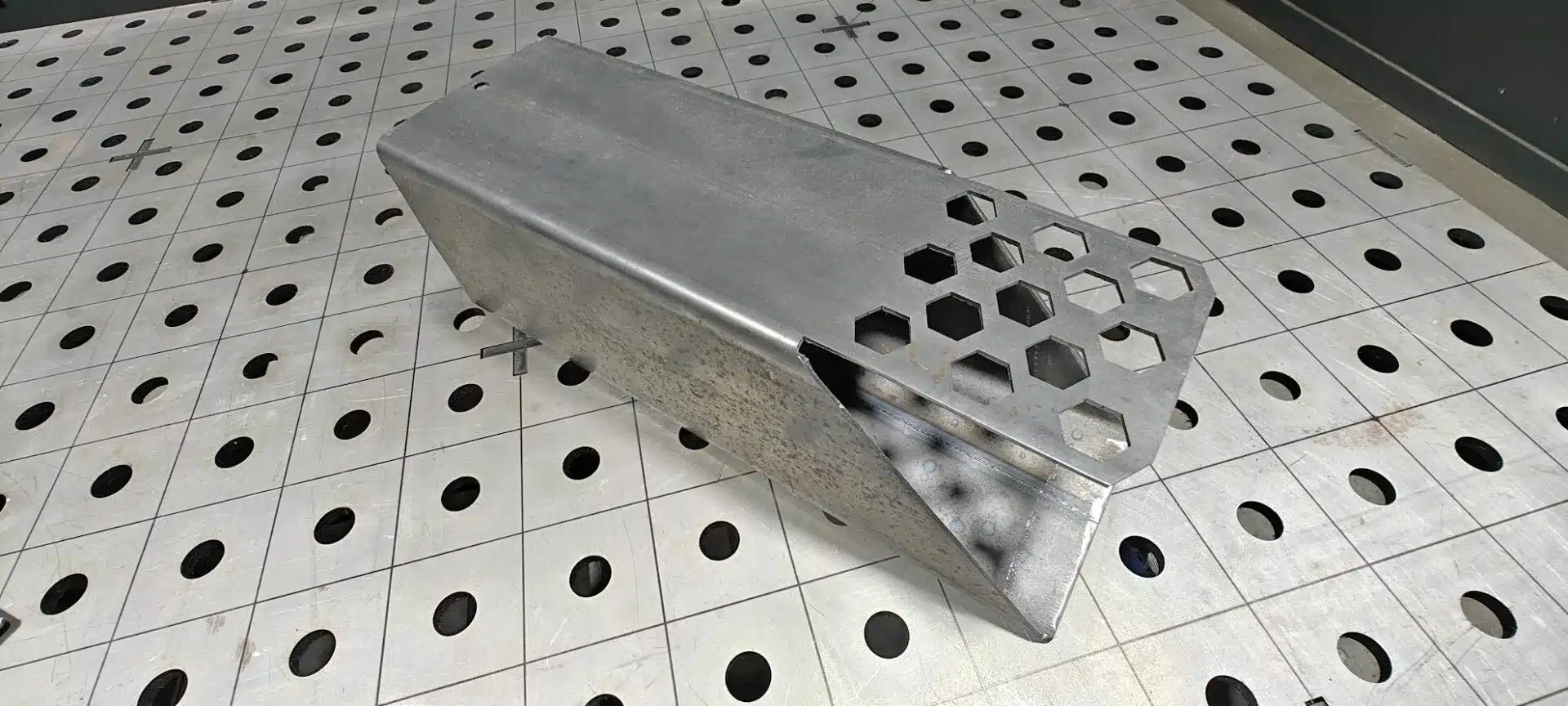

Another example of this is the fire grate. When fuel is dropped into the fuel chamber, it’s going to slide down the 60 degree incline towards the fire chamber. But it needs a grate to prevent it from sliding all the way down into the bottom of the upright stack.
In other designs, if they even incorporate this feature, you’d need to manually fit and weld something in. But again, thanks to the tube laser, when we cut the bottom air inlet tube, we leave the grate integrated to save effort.
Rocket-Stove-Air-Inlet-Tube-Grate

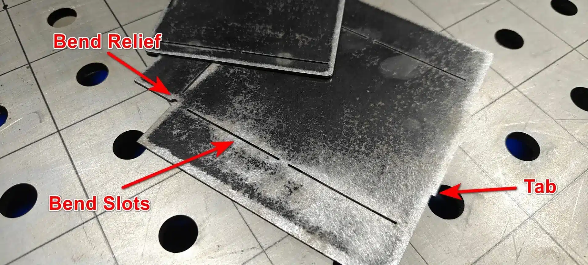

Instead, I integrated a removable tray which slides out the back side. Now, this tray has parts that need to be bent, and we could have bent those in our shop on our press brake, but it would add cost and the point is to keep the cost of the kit low, so I designed in little laser cut slits to make it possible to hand bend the parts where necessary.
Bend-Slots
There are also tabs and slots to make it quick and easy to put the bottom tray and the side panel together without having to measure.
