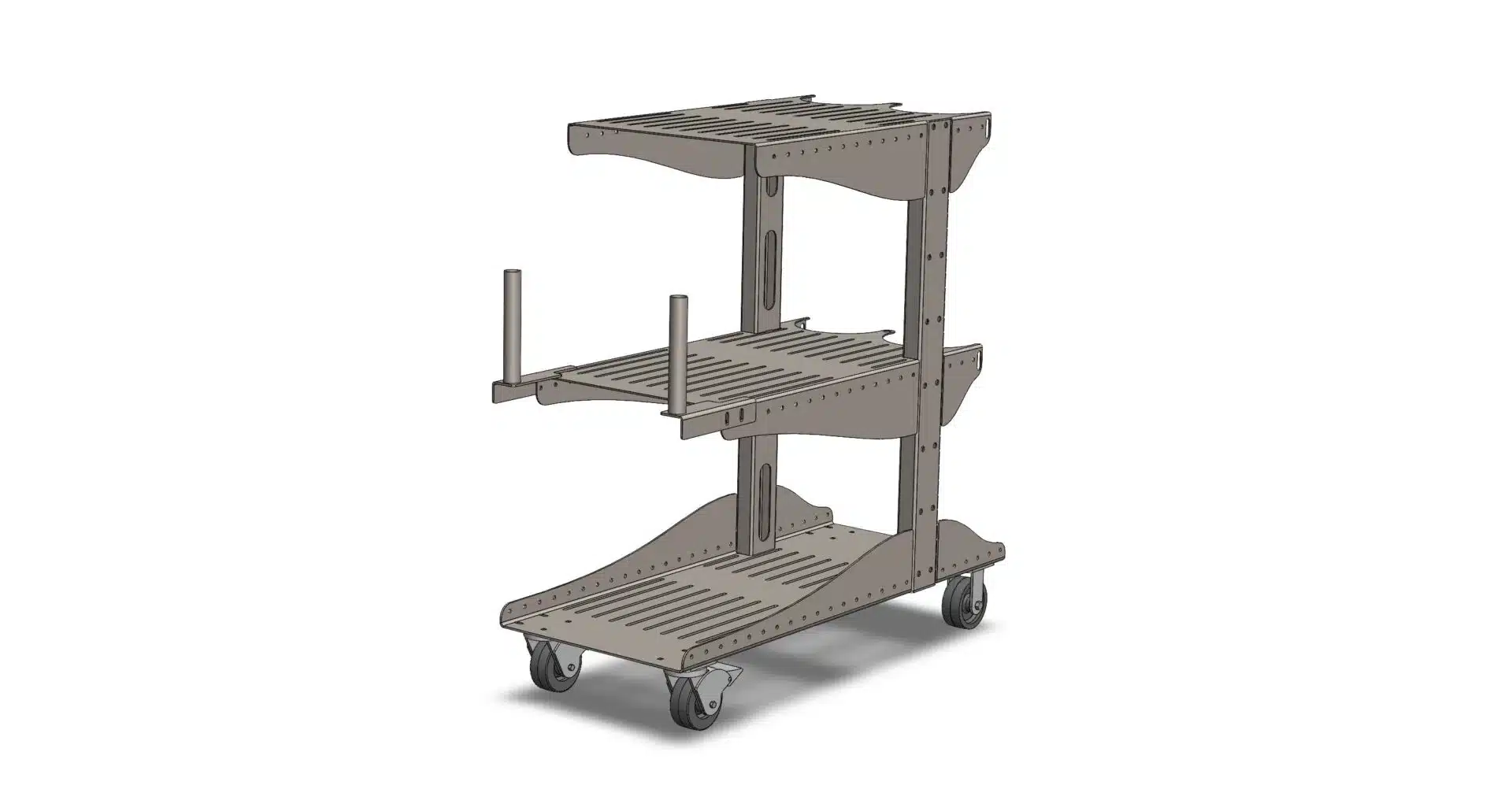

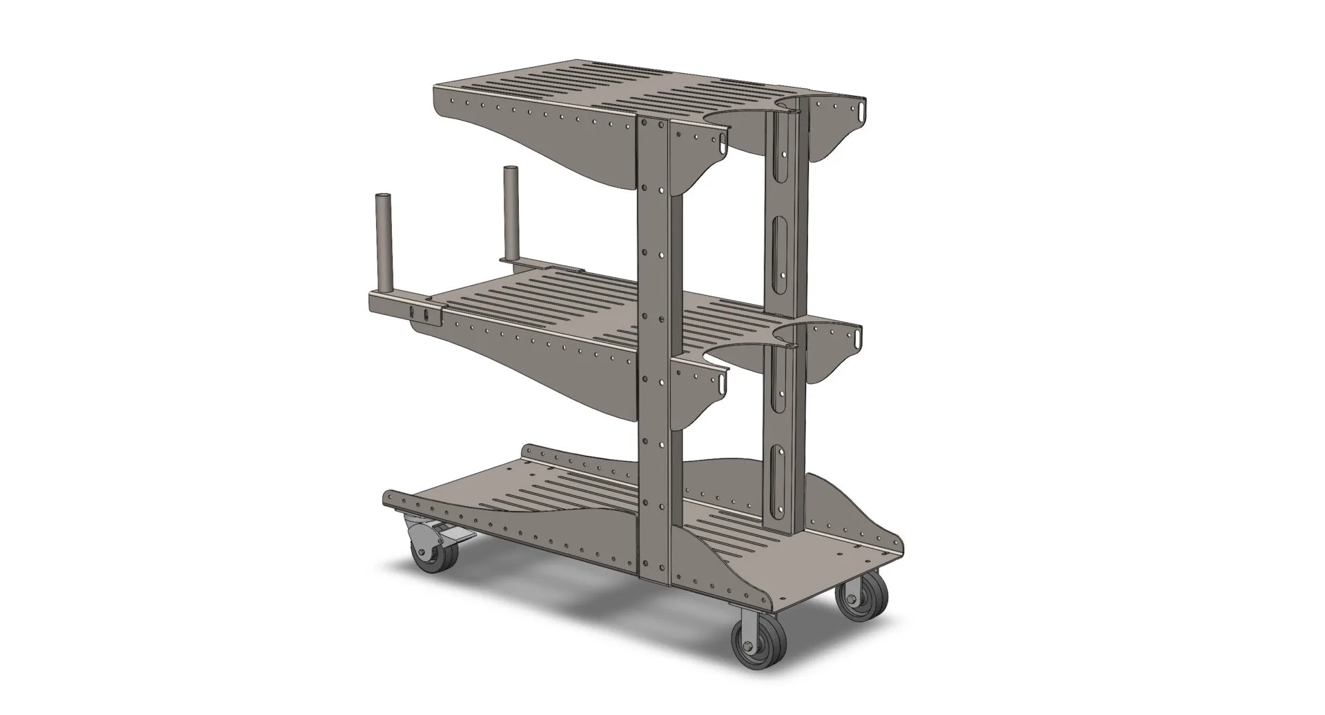

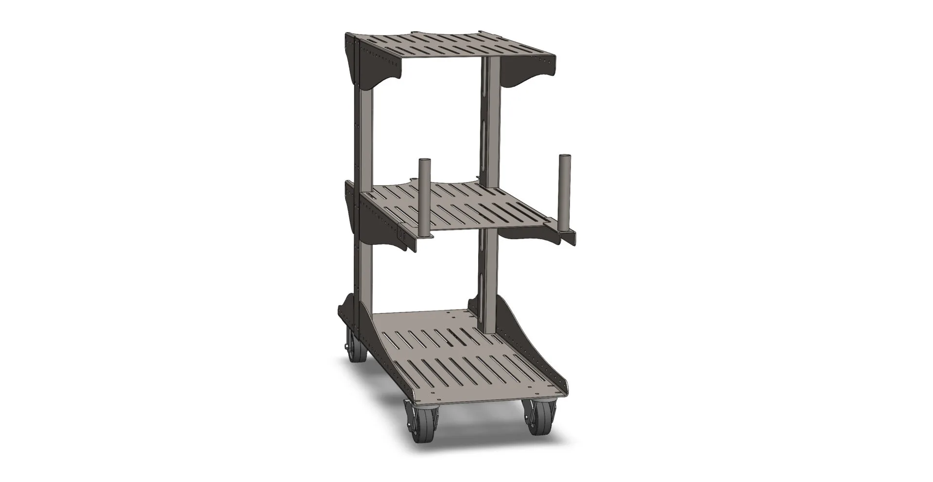

    Quick update on the development of the tri-level welding cart.
    • We trimmed down the length and width of the cart. It will still handle fairly big welding machines, but hoping to lighten it up a bit and shrink the footprint.
    • The second prototype also uses 10ga instead of 3/16″ steel. Again, should still be very strong, but losing a little weight.
    • Moved the casters out to the farthest edge of the bottom plate to give the most stability possible.
    • Adding some break-off tabs to be used during bending (no pics) to make it 10x easier to index and bend the shelves.
    SLDWORKS_0V64gJJRQz
    SLDWORKS_BtkrbzD22L
    SLDWORKS_QdM4V08DMX
    SLDWORKS_c81uazv3DR
    We’re going to build this second prototype version and hoping this kit will be good to go! Looking forward to using this in my garage at home for all my machines.
    I’m also kind of wondering if anyone will come up with other uses for this cart. I’m guessing there are other things which might be good to mount on a cart like this, but drawing a blank. So if you have any ideas please share.

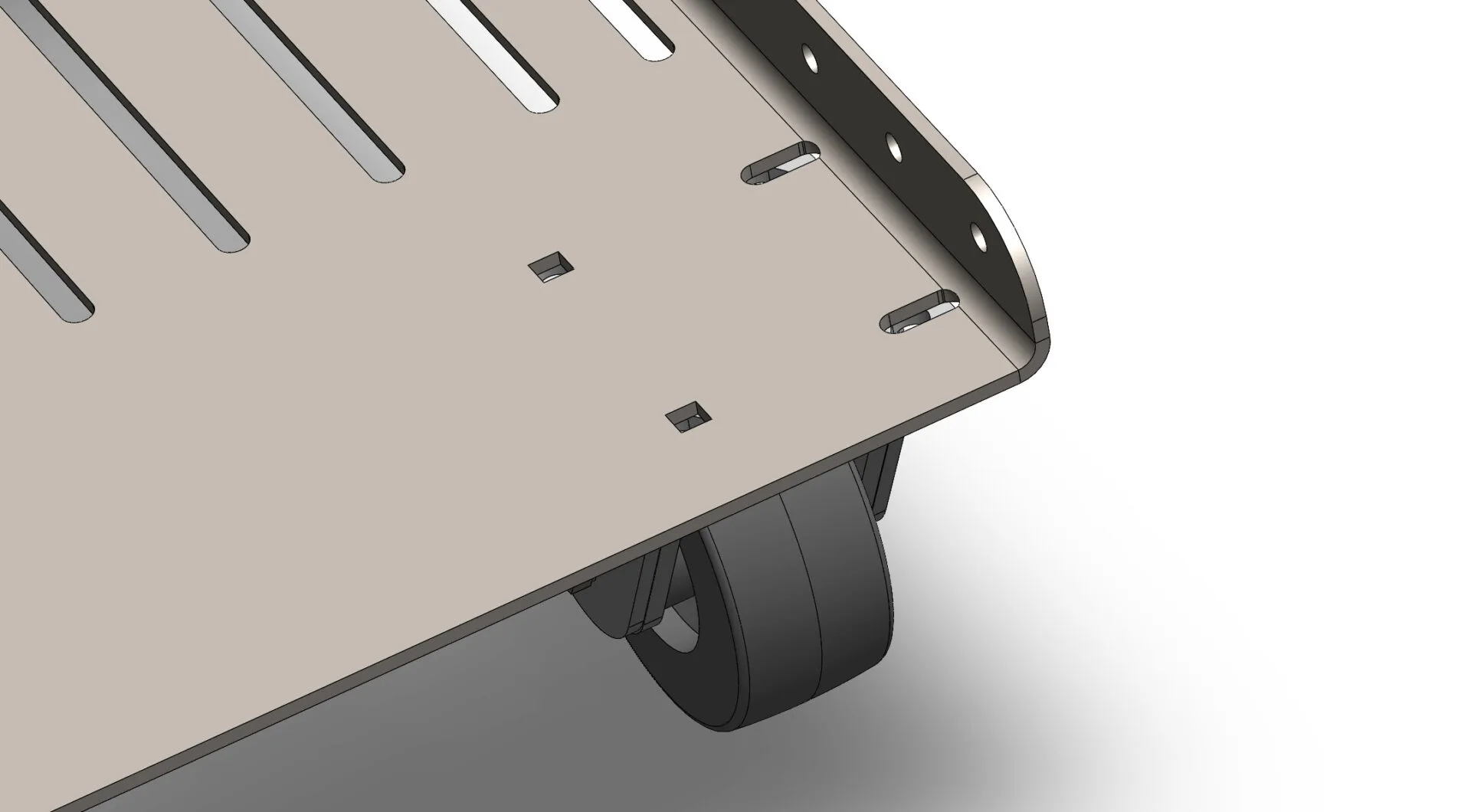

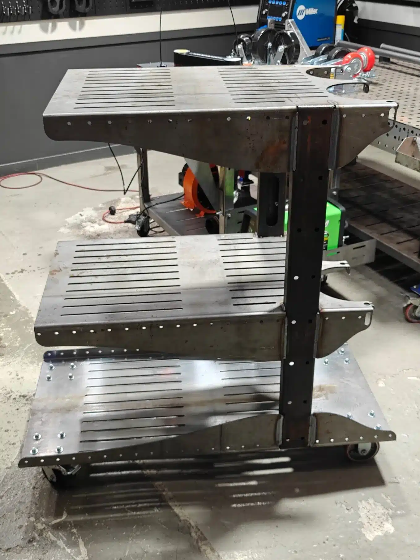

    Ok, so we redid almost the entire design, and also dropped down to 10ga material. I’m much happier with all the dimensions and the look and utility of the cart – BUT… we made a critical error in the new design. We thinned the material, but we also left all of the slots in the bottom and top layers near the two posts that bear all of the weight of the structure.
    IMG20250829125852-EDIT
    If it’s not obvious, the problem with this is that if you push sideways on the upright, it flexes the bottom and top sheets where the slots are! And if we put a lot of weight on the cart, it’s going to be basically floppy.
    IMG20250829125840-EDIT
    So, I think we’re getting close but there are a few things we’re considering:
    • I think we need to thicken the material back up a bit. At least 3/16″.
    • We need to get the slots away from the upright tubes altogether.
    • We MAY need to add some additional cross bracing to stiffen it side to side.
    I’m hoping that just the first two will be enough for the whole thing to be rigid and strong. I THINK it will, but we have to see. And the fall back would be to add some stiffening across the uprights to make it more of a fully boxed frame.
    John P.
    Texas Metal Works
    Founder
  • #37032
    Looking good. I have 2 carts i built out of mechanics tool chest, I like the storage but they are just to big. I like your prototype, just needs handles to move it around with and hooks for leads. With 3 machines on it there will be a lot of power cords and welding leads, may be some problems with that many cords and leads. Every time you want to use a machine you have to untangle leads, I know because I have a welder and plasma cutter on 1 of my carts, even with separate hooks it is still messy to get 1 machine going.
